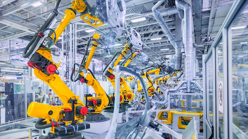

Large industrial plants may use multiple control systems that require multiple controllers to communicate with each other.
Figure 1. Large industrial plants may use multiple control systems that require multiple controllers to communicate with each other. Image used courtesy of Adobe Stock
