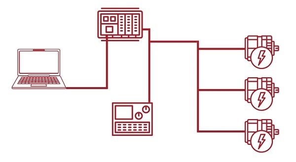

Simpler control system architectures may have an isolated network shared between different functions, and this doesn’t need an internal network firewall at all. But more often, when such a segmented network is connected to anything else, that’s when a firewall would likely enter the equation. That being said, some more complex control system architectures include firewalls between the separate functions, for example between operator interfaces and controllers, to protect against some forms of operator mistakes or interface misuse. They might also exist simply to protect the controller network interfaces from having to interact with unexpected network packets at all, keeping their performance focused on their intended tasks.
 Figure 2. An isolated network like this example might not need an internal firewall, except to prevent excess traffic between devices; an efficieny issue, not for security.
In circumstances where an industrial network segment is physically connected to another network, like employee emails or other services, or to another segment of the architecture, the gateway between those networks would often be a firewall or a router performing firewall functions.
