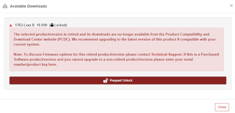

Screen capture of selecting the software download option
Figure 3. Select the software download option.
You will need to select files (Figure 4) and request the software be unlocked (Figure 5).
Screen capture of selecting files for download
Figure 4. Select files for download.
Screen capture of requesting a software unlock
Figure 5. Request a software unlock.

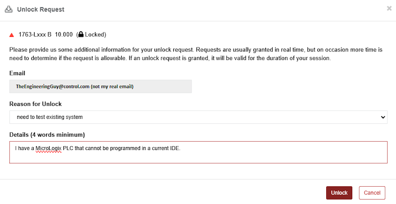

In the Unlock Request pop-up, enter your email and the details for your unlock request (Figure 6). This is not a difficult process; simply provide a brief reason for your request. My reason is quite simple: I have a PLC that cannot be programmed in the most recent software IDEs.
Screen capture ofjustifying your request for access to the software
Figure 6. Justify your request for access to the software.

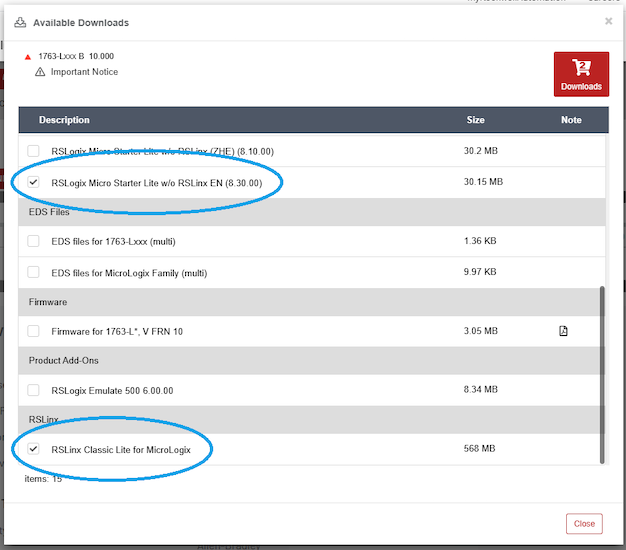

You should now have access. Next, you will need to install the RSLogix Micro Starter Lite and, maybe, RSLinx Classic Lite (Figure 7). If you have a current installation of other Rockwell software, you might have RSLinx Classic already installed. If so, you only need the Micro Starter Lite.
Screen capture of selecting the software for both programming
(required) and connection (optional)
Figure 7. Select the software for both programming (required) and connection (optional).
Once these are downloaded and installed (you can use the Rockwell Download Manager or direct download process), you’re all set to program a MicroLogix 1000/1100 PLC.

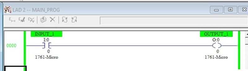

Drag in one new rung.
Click on the Examine if Closed (XIC) command and drag it to the left side of the rung until the box lights up green. Type in the address of the first input terminal: I:0/0.
Similarly, drag a momentary Output Energize coil (OTE) to the right side of the run. Use the very first address in the output file: O:0/0, as shown in Figure 13
Screen capture of the final PLC program in RUN mode
Figure 13. The final PLC program in RUN mode.
To download this program, go to the online menu and select ‘Download.’ If you are not prompted to go to RUN mode, select the online menu and choose RUN.
