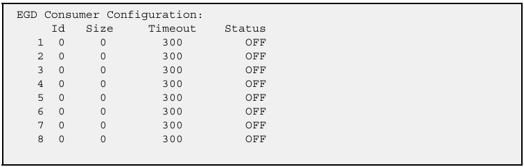

Consumer Configuration
To access the consumer configuration, press the arrow key down after entering the producer configuration(s) for all connections.
Unlike what we see in the producer configuration, there is no IP address because this robot is the consumer.
ID: Enter the exact exchange ID that the producer robot is broadcasting.
Size: The same number of bytes as will be sent from the producer.
Timeout: Trigger an alarm or error condition if a message is not received from the producer within a certain time. The recommended value is 3x the timeout value of the producer.
