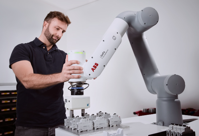

ABB demonstrates a GoFa cobot performing an electronic application by picking and placing circuit breakers.
ABB demonstrates a GoFa cobot performing an electronic application by picking and placing circuit breakers. Image used courtesy of ABB
