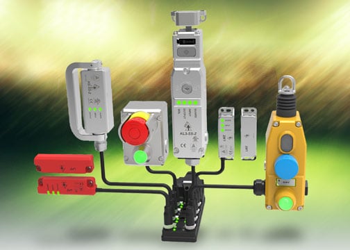

IDEM Z-range safety devices, now carried by AutomationDirect
A variety of different safety switches are offered by Z-Range, and can be configured for virtually any machine. Image used courtesy of AutomationDirect
At first glance, it is easy to think of safety systems as simple buttons and switches. This is not the case. The Z-Range line of safety switches includes RFID locks that can only be opened by operators that carry the proper credentials. Furthermore, each safety switch has onboard diagnostics. This way, if a switch has an issue, it self-reports the information. The diagnostics can prevent the dangerous situation where an E-stop is pressed, but is not functioning properly.
The idea behind the Z-Range Safety System is that all of the available data goes directly to a control system for processing and stopping the equipment. This eases the amount of wiring and the troubleshooting of wiring. For example, E-stops should be placed within an arm’s reach around any part of the machine. A large machine might have ten E-stops, plus multiple cabinet interlocks (to prevent unauthorized access in moving machinery) and other devices. Instead of trying to manually connect all of these components (perhaps running the E-stops in series, or connecting them through cascaded OR gates), all of these components can instead be wired to a safety system, such as those offered by Z-Range.
Also, the Z-Range components are designed for the rugged industrial or manufacturing environment. They conform to Safety Integration Level 3 (SIL-3) standards and Performance Level e (PLe), which are some of the strictest ratings for safety equipment. They are shipped with pre-made wires and T-block connectors, saving installation time.
