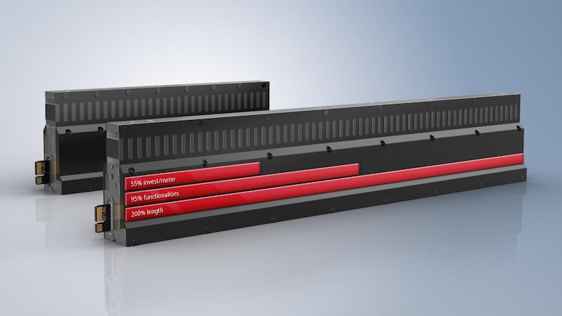

Beckhoff has recently announced its latest innovative solution, the XTS EcoLine motor module, a cost-saving addition to its eXtend Transport System (XTS). Designed as a more affordable entry to advanced mechatronics, the new motor module delivers 95% of the performance of the existing XTS module at 55% the cost per length. The module is also fully compatible with the existing XTS portfolio, making it suitable for various cost-sensitive applications.
The new XTS EcoLine motor module.
The new XTS EcoLine motor module. Image used courtesy of Beckhoff
Compact Design with Extended Length
The new XTS EcoLine motor module doubles the length of a standard straight XTS module, featuring a length of 500 mm, which increases flexibility in transport, all while maintaining the exact grid dimensions as the standard modules. Despite having a lower price point, the new motor module retains some of the performance specifications offered by the XTS family, supporting fast accelerations of up to 10 g and high travel speeds of up to 4 m/s, making the solution suitable for high-throughput production environments.
