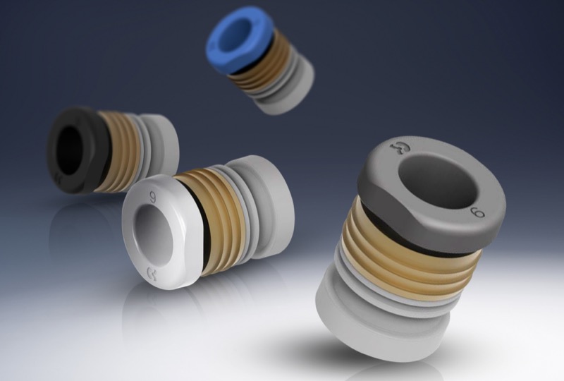

Push-to-connect fittings are honestly a dime a dozen. However, it’s not uncommon for them to get in the way, especially with some of the larger sizes. Camozzi Automation has developed a unique solution for these small fittings with its CARTfit Series 7700, a one-piece push-in cartridge designed to create a secure, repeatable connection between a housing and a tube. The cartridge is intended for use within engineering polymers, brass, or aluminum and is installed using a simple press-in process.
The CARTfit Series 7700.

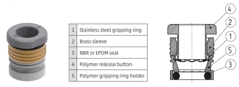

The CARTfit Series 7700 shifts the push-to-connect function into the housing itself. Instead of attaching an external fitting, the cartridge is pressed into a machined hole cavity. Note the user manual for specific machining requirements. Here, it becomes the permanent tube interface. The tube is then inserted directly into the housing, with the cartridge providing retention and sealing at that location.
The CARTfit Series 7700 is pressed into a machined housing cavity, turning the housing itself into the push-to-connect tube interface.
The CARTfit Series 7700 is pressed into a machined housing cavity, turning the housing itself into the push-to-connect tube interface. Image used courtesy of Camozzi
The CARTfit Series 7700 replaces multi-component tube fittings with a single press-in cartridge, reducing the number of parts required at the tube-to-housing interface. The cartridge accepts 4, 6, and 8 mm external tube diameters and installs into cavities machined in polymer, brass, or aluminum housings. Once installed, the cartridge provides a fixed sealing interface for push-in tubing.

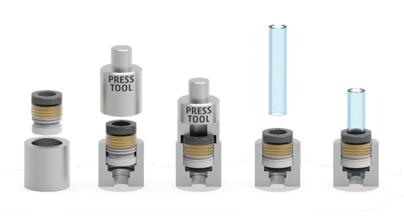

Installation of the CARTfit Series 7700 follows a controlled press-in process. The cartridge is aligned with a clean cavity and inserted using a dedicated press tool that applies a linear force until the end of the stroke is reached. Proper alignment and cleanliness are emphasized to ensure sealing performance.
Installation process for the 7700 series cartridge.
Installation process for the 7700 series cartridge. Image used courtesy of Camozzi
Once the cartridge is seated, the tube is simply pushed in as with any push-to-connect fitting, locking and sealing right away. Camozzi also offers optional tooling for automated leak checks, allowing testing without relying on manual inspection.
