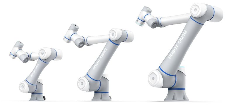

Dobot’s new CRA-IP68 series of collaborative robots is specifically built for use in harsh environments
Dobot’s new CRA-IP68 series of collaborative robots is specifically built for use in harsh environments. Image used courtesy of Dobot
CRA-IP68 Collaborative Robots
Under normal circumstances, industrial robots are used in fairly dry and clean conditions. Some robots are designed to withstand paint booths or sanitary conditions, but Dobot’s new CRA-IP68 collaborative robot series has some other design features up its sleeve.

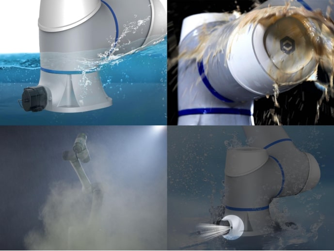

In sanding and grinding applications, extensive dust is produced, which is typically why you wouldn’t want to use a robot for the application. The CRA-IP68 cobot has specifically designed joints that resist dust from entering the robot.
Cutting machines require constant attention to loading and unloading parts. They also use a special cutting fluid that contains oil, and this oil can sometimes break down the soft exterior shell of a collaborative robot. The CRA-IP68’s exterior is made of fluororubber, which resists corrosion from chemical cutting fluids.

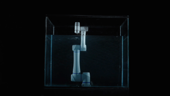

The CRA-IP68 cobot showcasing its waterproof capabilities
The CRA-IP68 cobot showcasing its waterproof capabilities. Image used courtesy of Dobot
To aid in the ability to withstand harsh conditions, the IP68 has an internal pneumatic system. This system applies positive pressure within the arm to aid in sealing of all the moving joints.
The CRA-IP68 series is offered in three models with varying payload and reach: a 5 kg payload with a 900 mm reach, a 10 kg payload with a 1,300 mm reach, and lastly, a 20 kg payload with a 1,700 mm reach. Each model has an IP68 rating, which makes the arm completely dustproof and able to be submerged in water.

Wet, dusty, or oily conditions are no match for the CRA-IP68
Wet, dusty, or oily conditions are no match for the CRA-IP68. Image used courtesy of Dobot

Cobots are a great tool for users without years of robot programming experience and who want a robot to perform a remedial task. More often than not, these remedial tasks are in wet, dusty, or oily conditions, which will wreak havoc on typically collaborative robots. CNC machine tending is one of these applications. When the doors open to remove the workpiece, the coolant drips from every surface. With the CRA-IP68, there is no need to fear the dripping coolant as the exterior and the joints will resist water and oil.
Any facility that handles food is required to be washed down and cleaned to inhibit bacteria growth. Collaborative robots are great choices in food preparation as they are easy to program and can quickly be repurposed to another task. With the CRA-IP68 being able to withstand water sprays and the control cabinet being IP54-rated, the CRA-IP68 would be right at home in a sanitary environment.
