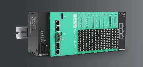

The company is offering machine builders its G-Mation platform with the P6 PLC at its core, potentially a system to cut through complexity without compromising on quality. G-Mation combines high-performance industrial control with an app-based, cloud-friendly architecture designed to bridge the gap between operational and information technology on a single platform. It’s modular, open, and perhaps most importantly, built with both engineers and operators in mind.
Gefran’s G-Mation P6 Controller.
Gefran’s G-Mation P6 Controller. Image used courtesy of Gefran

At the heart of the G-Mation platform is a shift in thinking. Instead of hardcoding every function into the system, Gefran built the P6 PLC around Docker container technology. This is the same technology that powers much of today’s cloud computing. This allows machine builders to add new capabilities such as app integration. If the time is right, it can be pretty neat to make industrial machines move right from a smartphone. Need a new diagnostic tool or visualization tweak? Just deploy an app. No need to rewrite code or stop the machine.
Despite this flexibility, the platform doesn’t sacrifice performance. Control tasks are handled in real time using EtherCAT. The P6 can manage two separate EtherCAT networks, supporting a variety of topologies, which include ring, star, or tree, to give engineers the freedom to design systems their way.

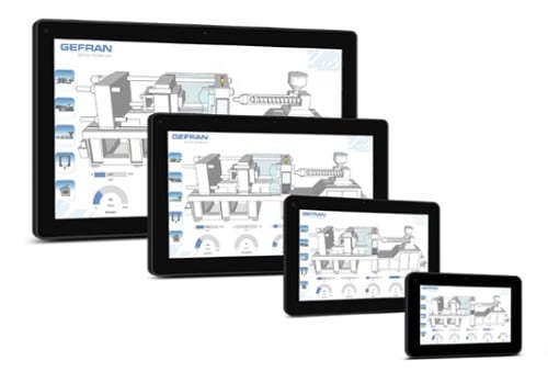

The P6 also includes an embedded web server that generates HTML-based HMI pages that are viewable on any browser. These pages automatically scale to the device’s screen, offering a user experience that's more like a modern app than a traditional industrial interface. For customers using older systems, support for Java-based UIs remains to offer a smoother transition to the new platform. For those ready to upgrade, the HTML interface provides drag-and-drop customization and intuitive layout options with no coding required.
G-Mation V44 HMIs.
G-Mation V44 HMIs. Image used courtesy of Gefran
