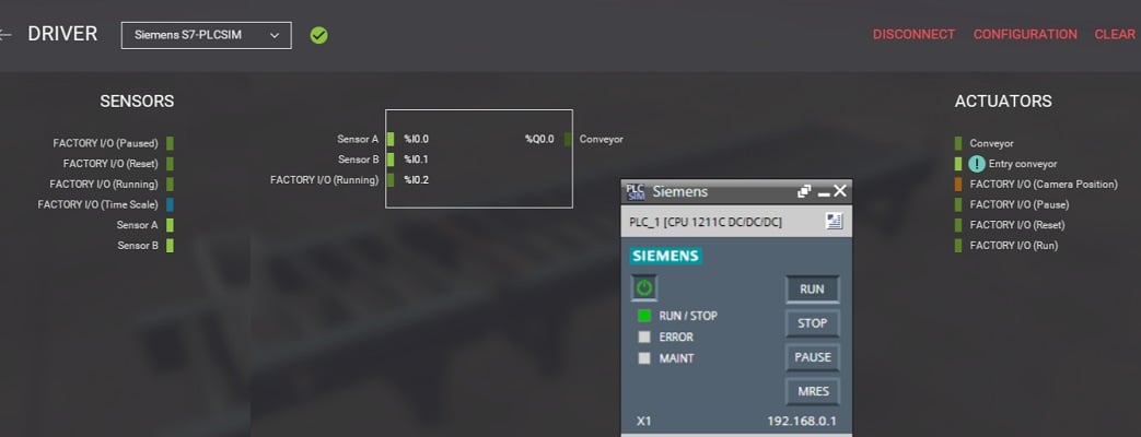

After adding the scene, add the driver by clicking ‘File’ and then ‘Drivers’. In the dropdown menu, choose Siemens S7-PLCSIM instead of Siemens S7-1200/1500, which is used for physical PLC hardware. With the PLC simulation software open, click ‘CONFIGURE’ in the top right corner to open a new window. Set the CPU model to S7-1200, return to the driver selection window, and click ‘CONNECT’. A green tick icon will appear next to the driver to show the connection is successful.
 Figure 3. Successful connection of Factory I/O setup and S7-PLCSIM indicated by the green icon.
Once you are connected, map the I/O by dragging and attaching the input and output devices as shown in Figure 3. Next, add PLC tags in TIA Portal that match the ones in the Factory I/O driver. In the project tree, add a new data tag and assign names to the inputs as shown below. After mapping the I/O, you can set up basic control logic for the scene using start/stop latching logic.

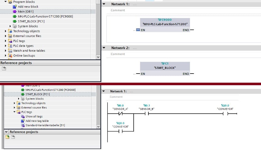

In the project tree, under program blocks, add a new function block and name it ‘START_BLOCK’. In the first network of the function block, set up the ladder so that when SENSOR A is triggered at the start of the conveyor, the conveyor output is latched. When SENSOR B is triggered, the latch is released, and the conveyor stops. After you finish the logic, call it (START_BLOCK) in the Main (OB1) in the second network and then compile. The choice of input as normally closed or open contact depends on the sensor’s signal when not activated. For instance, in this project, the retroreflective sensor gives a true signal unless the reflective path is blocked, making the use of its normally closed contact as a trigger practical, rather than normally open.
 Figure 5. Main OB1 in the top image shows the default communication block and the START_BLOCK function. The START_BLOCK function block (bottom) shows the implemented ladder for the scene.

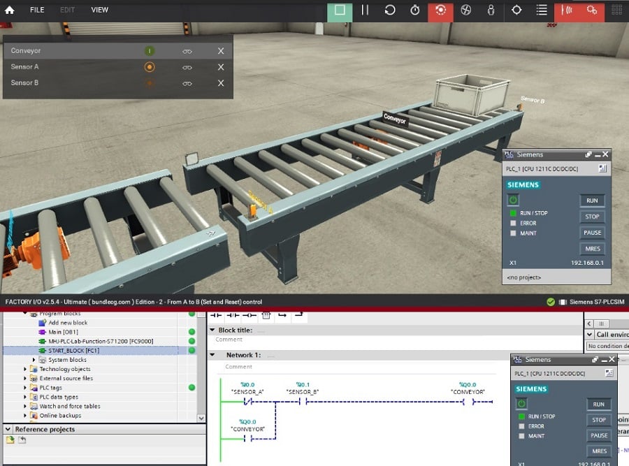

After you compile the program, download the logic to the virtual PLCSIM and switch it to RUN Mode. This way, the PLC program will respond in real-time as inputs change in the Factory I/O environment. To test your project, go back to Factory I/O and click the ‘Play’ icon. The conveyor should start and stop when the bin reaches the end.
 Figure 6. Real-time monitor response of PLC logic showing cancelled latch and the Factory I/O scene showing the bin at sensor B.
If your project does not work as expected, there may be some common issues causing the problem.
First, check for mismatched I/O addresses, look for input changes that do not match output actions, and verify that the PLC is in RUN mode. To find these issues, use diagnostic tools in TIA Portal to watch the state of tags as the logic runs. Factory I/O’s diagnostics, like a lighter green color when active and a dull green when off, can also help you check sensor activation and actuation commands. Using both tools helps you figure out if the problem is with the PLC logic or the simulation setup.
