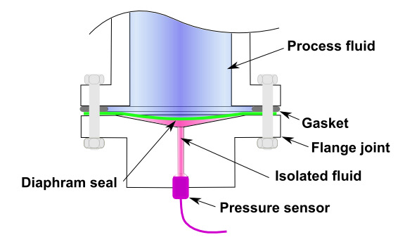

A diaphragm valve restricts the flow of product through the valve body by reducing the size of the opening in the valve; this makes the diaphragm valve a great way to reduce flow without additional components in the system. The ThinkTop V55 uses digital communication technology to control the size of the valve opening accurately and allows for real-time monitoring of the valve position. To help prevent unexpected downtime, the V55 uses internal diagnostic technology that monitors the valve's health and can report when the valve will need servicing. The multi-colored LEDs that surround the V55 are indicators of the valve's status and position. The user will find two configuring buttons and more status LEDs if the top is removed.
The ThinkTop V55 connects to a diaphragm valve to monitor and control the flow of fluids.
The ThinkTop V55 connects to a diaphragm valve to monitor and control the flow of fluids. Image used courtesy of Wikimedia
