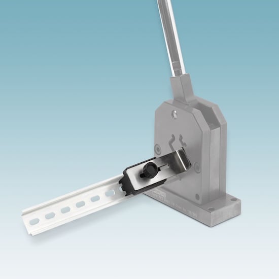

This is the very problem the Phoenix Contact Zero-Cut Block was designed to solve. Instead of tedious measuring, marking, and cutting, the Zero-Cut Block secures the DIN rail and performs repeatable cuts, giving installations a professional look. It drastically reduces installation time over manual measuring and cutting.

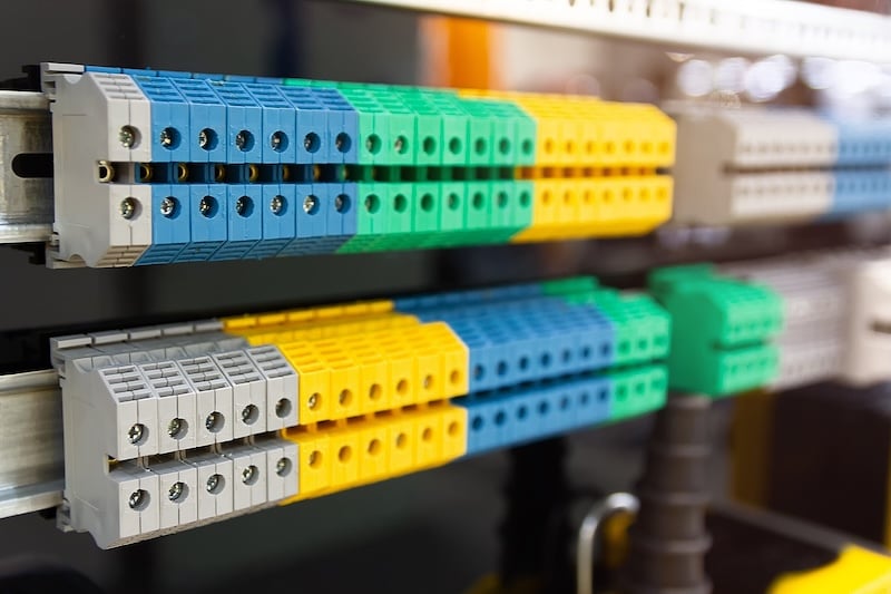

A row of terminals mounted on DIN rail.
A row of terminals mounted on DIN rail. Image used courtesy of Adobe Stock
Zero-Cut Block
Phoenix Contact has introduced the solution to these headaches. The Zero-Cut Block is a gripping and cutting device that reduces the fabrication time of DIN rail sections. Its design has a locking pin that grips the perforations in the same spot every time, ensuring uniform cuts. The device also has a magnetic grip that holds the DIN rail in place while the operator pushes down on a long lever to cut the bar. Measurement and cutting are performed on the same device, saving time and effort.
The Phoenix Contact Zero-Cut Block contains the block to specify spacing, the cutting lever, and multiple channels to accommodate different sizes of DIN rail.
The Phoenix Contact Zero-Cut Block contains the block to specify spacing, the cutting lever, and multiple channels to accommodate different sizes of DIN rail. Image used courtesy of Phoenix Contact
The Zero-Cut block is designed to handle multiple sizes of DIN rail, including NS 35/7,5, NS 35/15, and NS 15. The long cutting lever gives the technician the leverage needed to cut through the DIN rail without requiring them to be a professional bodybuilder. The cutting block is adjustable, but once it is set, it can be left in place for many cuts.
Cutting or snapping the DIN rail in this manner reduces the chances of injury compared to using a handsaw or power saw. Clamping of the rail can be performed repeatedly without having to tighten and untighten a vice many times over or, even worse, using no vice at all. In terms of safety, the Zero-Cut Block reduces hazards significantly.
