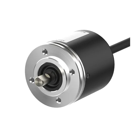

EP50S Series Rotary Encoders
Autonics’ new EP50S series of single-turn absolute rotary encoders are designed to report the position and speed in automated systems, offering a reliable and accurate solution for industrial motion control. They are available in a 50 mm size housing with an 8 mm solid shaft.
One of the key advantages of the EP50S series is its high resolution. The encoders are available in resolutions up to 1024 pulses per revolution (PPR). This ensures accurate position feedback, making it ideal for applications like plastic extrusion, parking tower positioning, and elevator and lift control.

The EP50S series rotary encoders come equipped with several features that make them suitable for different applications. The encoders are offered in models that produce various output codes, including BCD, binary, and Gray codes so that the series can be integrated into different machine designs and motion control setups. Users can also choose from axial or radial cable-type models to suit their individual needs without having to change existing equipment.
The encoders support two output types, NPN and PNP, allowing seamless integration with a broad range of automation equipment and controllers. Autonics encoders are built with aluminum housing and are rated to IP65, making them resistant to dust and moisture. An IP65 rating and UL certification (depending on the model) can give manufacturers peace of mind that the encoders will operate in harsh industrial environments.
