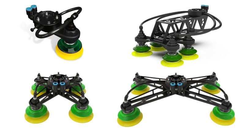

The PowerPick 10, 20, and 30 enable gripper customization in palletizing, pick-and-place, and machine-tending applications
The PowerPick 10, 20, and 30 enable gripper customization in palletizing, pick-and-place, and machine-tending applications. Image used courtesy of Robotiq
PowerPick Vacuum Grippers
More significant and oddly shaped parts require different suction tools. Robotiq’s PowerPick vacuum grippers are available in different configurations to suit application needs and come with a vacuum generator that can be attached to the base of your robot. The PowerPick can be ordered as a single cup, a quad cup with three different sizes (10, 20, and 30), and as the PowerPick Multi, Robotiq’s newest gripper, which has 24 vacuum cups.
All of the PowerPick grippers are designed for plug-and-play into many popular collaborative robots, reducing programming and training time. The maximum payload for the PowerPick 10 is 13 kg, while the PowerPick 20 can lift 18.2 kg, and the PowerPick 30 can lift 27.2 kg. The PowerPick 10 has a vacuum flow of 180 l/m, while both the PowerPick 20 and PowerPick 30 consume 376 l/m. The PowerPick SingleCup has a max payload of 6.5 kg and a vacuum flow of 180 l/min. All of the PowerPick grippers require a compressed air source.

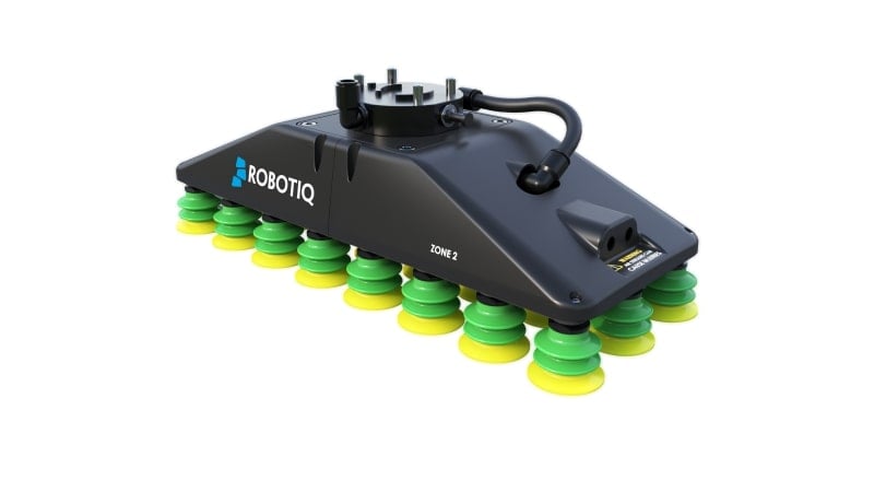

Robotiq’s newest gripper, the PowerPick multi, features 24 vacuum grippers and a max payload of 30 kg
Robotiq’s newest gripper, the PowerPick multi, features 24 vacuum grippers and a max payload of 30 kg. Image used courtesy of Robotiq
The PowerPick Multi
If your palletizing application handles a variety of different shapes and sized objects, you might want to have a look at Robotiq’s latest gripper, the PowerPick Multi. Twenty-four vacuum grippers are arranged in an array that can be operated in recipe-driven zones, which allows the picking of larger or smaller objects without a changeover. The PowerPick Multi uses the URCap, which interfaces with the cobot’s force sensors, enabling quicker picks and reducing damage to delicate parts. The PowerPick Multi uses up to 392 l/m of vacuum, has a grip cycle time of 0.14 seconds, and a payload capacity of 30 kg.
