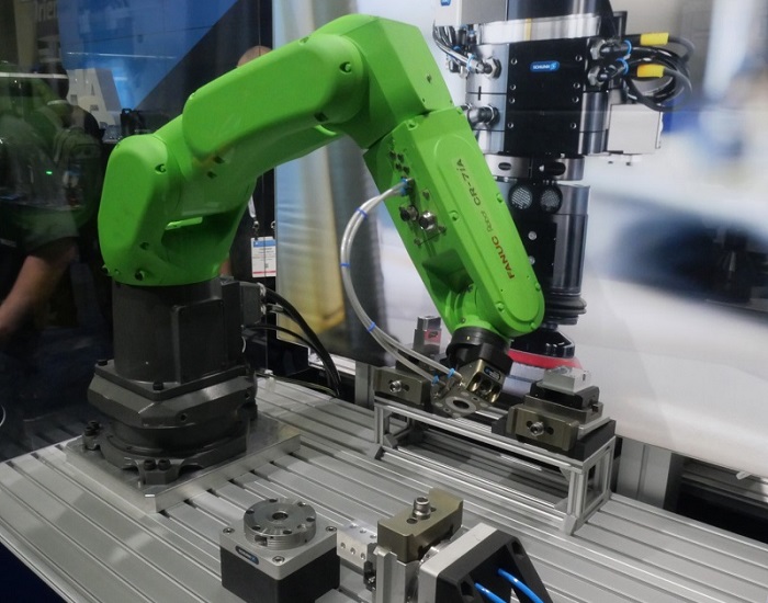

A FANUC cobot from the CR series
Figure 1. The CR-7iA, a member of FANUC’s original collaborative robot series. Image used courtesy of the Control Automation engineering team

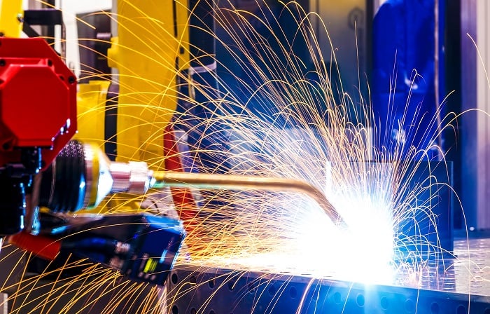

Motor Overheating
Motor overheating is common among 6-axis robots. This problem often occurs when users input incorrect load settings, such as payloads. This leads to abnormal acceleration and deceleration, causing the average current to rise and the motor overheating.
Another primary factor that can lead to motor overheating is high ambient temperatures. To effectively mitigate this issue, it is crucial to lower the ambient temperature and guarantee that the motor's environment is adequately ventilated to allow for efficient heat dissipation. Furthermore, if there is a nearby heat source, it is advisable to install shielding to safeguard the motor from heat radiation.
A robot in a welding environment
Figure 3. Harsh environments, welding included, can cause overheating if not properly mitigated. Image used courtesy of Adobe Stock
