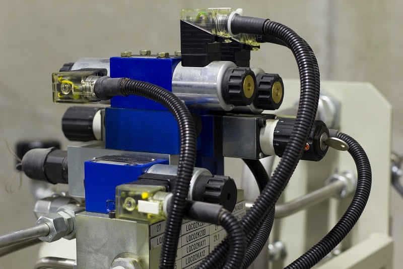

Two main differences will drive the focus of this article. Hydraulic systems use valves to control cylinders instead of using waveforms to spin motors, as in electrical actuators. These valves are called servo valves and are operated by an analog voltage coming from a motion controller. Please note that these are not proportional valves. Proportional valves generally lack the fine control needed for closed-loop control systems. Another major difference is that linear hydraulic motion uses feedback sensors - the linear position transducer.

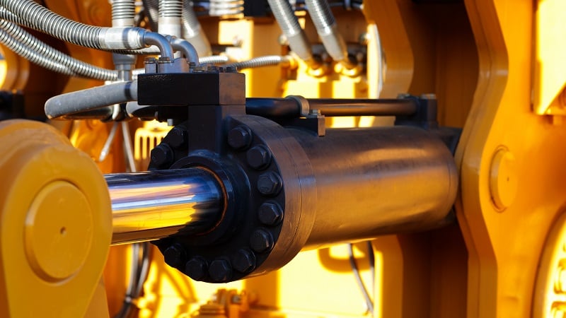

Second, there might be a broken piece of hardware on the motion axis equipment. Check for broken or binding pieces of linkage. In my line of work, sawmilling, we sometimes drop massive logs onto motion-driven carriages. If we were to have a 5000 lb log with clamps holding 3000 lbs of force down on it, this may be enough to halt the motion axes if they need to skew the log aggressively for a cut. The broken piece of hardware may also be the cylinder itself! Or a blocking valve, as mentioned before.
The third problem (and generally the most expensive) is a bad valve. Valves often cost upwards of $15,000. The best way to test a valve is to unload anything off the axis so it is free to move, then use open-loop voltage to force the valve to move. If open-loop mode doesn’t work, remember to check the voltage at the valve and make sure the meter reports both the feed voltage AND the control voltage. A Jog-Box is an alternative that provides hand-operated control so that all the wiring can be bypassed.

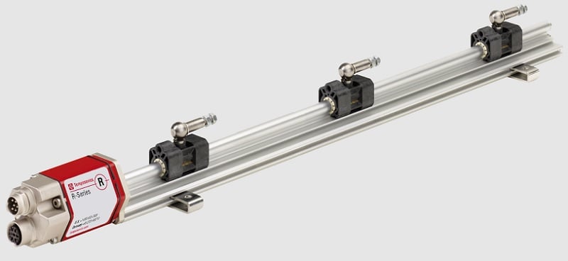

Linear transducers work by sending a pulse down the length of their rod. This pulse is reflected off a magnet in the cylinder and travels back to the sensor. The sensor receives the reflection signal and measures how long the pulse takes to return. The amount of time it takes to return is scaled by the sensor to determine the position of the magnet on the cylinder. They have a maximum and minimum travel time that they are programmed for. If a pulse returns in a longer time than the length of the sensor allows, the system will report an overflow error. There are generally two causes of this.
1: Transducer failure could be the issue. This is probably the easiest option when it comes to replacement.
2: If the cylinder sensing magnet fails, it could allow the waveform to continue without being reflected. If this happens, it may require a replacement of the magnet or the cylinder. This depends on how the cylinder was designed.
