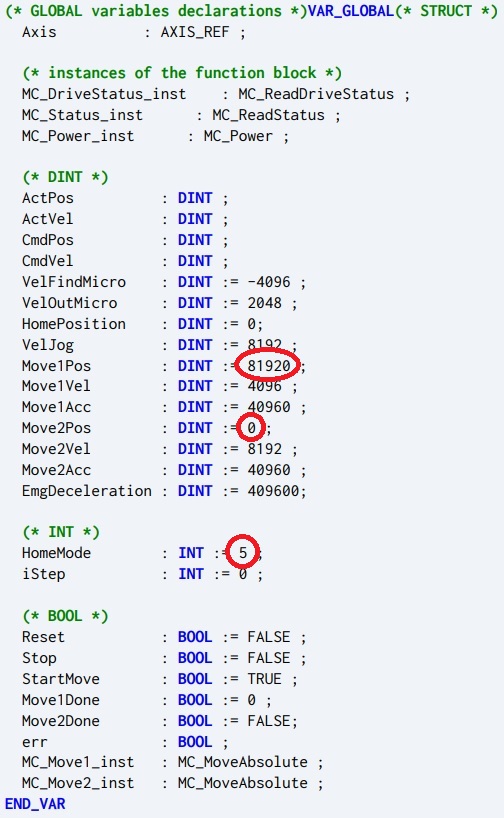

The first step is to define all of the data points, including velocities, target positions, and more. The code from CMZ (including the comments) shows the default values, but the red circles indicate locations where we must insert the values for our own system.
Examine the image below.
Figure 2. Setting up global variables.
In the DINT category (double integers), VelFindMicro and VelOutMicro work together to define the homing speed on the first program execution cycle. The VelFindMicro velocity of -4096 means that the axis will travel (quite slowly) in the negative direction until it meets the homing switch. As soon as that happens, it will then travel back in the positive direction, even more slowly, until the switch is released. The moment that happens, the current position is set to 0, thus completing the homing cycle. I would not recommend adjusting these values unless you are comfortable with faster homing.
Next, we see three elements defining Move1 and Move2. The position (Pos) is critical because the length of your axis is likely different from any default value provided by the example code. In the previous article, we measured the distance traveled by one rev of the motor (depends on your belt/ball screw setup, mine is 8.5 mm), as well as the number of increments per revolution (default is 8000). Some simple math shows that this default code would cause my axis to travel:
\[81920~inc \cdot \frac{1~rev}{8000~inc} \cdot \frac{8.5~mm}{1~rev}]\
This equals 87.04 mm, or roughly 3.5 in.
You can increase the velocities as you feel comfortable, but verifying the target position is far more important in this intro tutorial than teaching how to make the motor run faster.
Moving to the INT (integer) category, there is a selection for HomeMode, which deserves some explaining.

1 Travels to the homing switch (defined by your I/O). If it hits a software or hardware limit switch, it will halt with an error. This is the value I used in my code, since I do not have limit switches.

5 Does not move, simply sets the current position to 0 (or whatever is in the HomePosition variable). WARNING: If you have properly homed the axis, but then it halts in a random position and the code is re-executed, this will become the new zero position, and your target positions will likely travel beyond your actual hardware limits.

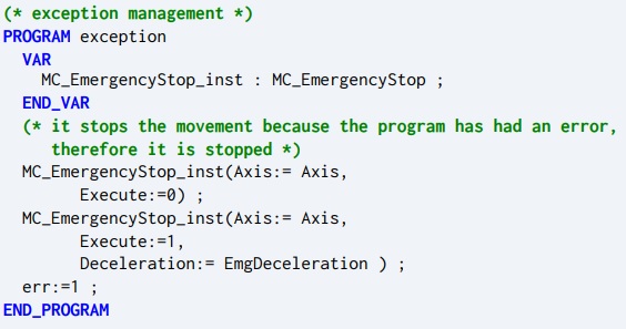

The final program element is the exception handler. This part also does not need to be configured in the case of a simple bench test.
 Figure 5. Exception management program.
