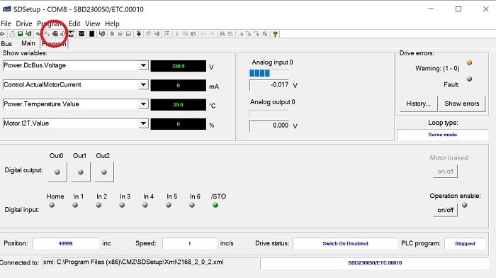

The Main screen displays information about the drive. Check the voltage of the input and the Bus, and ensure that they accurately reflect real values. If so, the drive is powered on and the software is communicating.
At this time, the STO light should be green, and if you have connected your homing switch to input 0, then it should illuminate green when the switch is pressed.
 Figure 4. Green STO indicator, and Drive Setup button (red circle).
Set up the Axis
From the Main screen, we can select the Drive Setup button, which links the operation of the motor to the physical axis system.

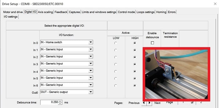

Next, move to the Digital I/O tab. From here, we can set Input 0 to IN - Home Switch. You can select Active Low for an N.C. limit switch or leave it the default Active High for an N.O. switch.
 Figure 6. Digital I/O. My ‘In 0’ is set for the homing switch. The red square highlights the actual homing switch.

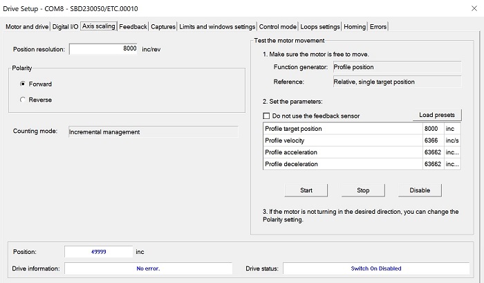

The next tab, Axis Scaling, is very important because without testing the motion, we can collide with the limits. Most of the defaults should be left as-is, but verify that the “Test the motor movement” box on the right side has a profile target position of 8000 inc/rev and press “Start.” The sliding axis should move away from the motor exactly the distance that you measured earlier with one revolution of the ball screw or belt sprocket.
  • If the axis does not move, check the Drive information box for errors, and open the Error window at the bottom to diagnose.
 Figure 7. Axis scaling, with the test Start and Stop on the right side.
These test motions are relative, so you can type + or - values in the target position box, and test various velocities so that you have a grasp of how the velocity units relate to mm/sec.
