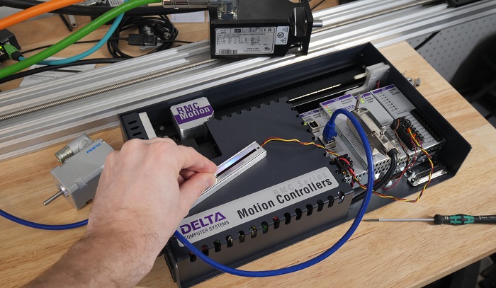

 Figure 1. This trainer uses a linear potentiometer as a set point signal so that it can be changed quickly but not instantly, which is useful for our demonstration.
Thanks to the Delta Motion team in Battle Ground, WA, I was able to borrow a training unit that can help us visualize these PID gains like never before.
