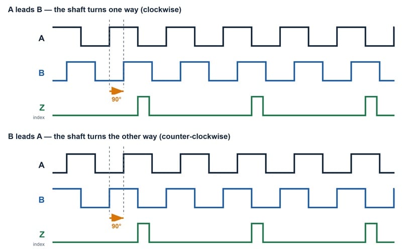

An incremental encoder's job is to emit three square-wave channels: A and B, which are 90° out of phase, plus the index Z, which provides one pulse per revolution. Most industrial encoders also output the complements /A, /B, /Z for noise immunity over long cable runs.
The shift in phase between A and B is what tells the controller the spin direction: if A leads B, the shaft is turning one way; if B leads A, it’s turning the other. This data is provided entirely in the timing, not in the voltage level. This is why swapping channels A and B is the classic "run backward" mistake, and why the output type matters more than people expect.
 Figure 1. Square wave profiles for detecting edges.
Figure 1. Square wave profiles for detecting edges. Image used courtesy of the author

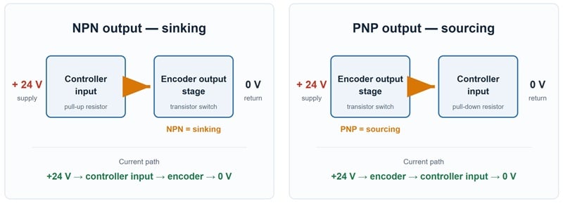

Both terms describe a transistor that is housed inside the encoder; they don’t refer to a voltage level. The confusion starts because both can share the same 0/+24 V rails and the same A/B/Z pins.
NPN (sinking): the transistor pulls the signal line down to 0 V when active. The load (the controller input) must pull the line up to +V through its own resistor. Current flows from the controller, through the load, into the encoder, to ground.
PNP (sourcing): the transistor pushes the signal line up to +V when active. The load must pull the line down to 0 V. Current flows from the encoder, through the load, into the controller, to ground.
The direction of current is reversed between these arrangements. A controller input built for one polarity reads the other as always-high or always-low; it never detects a transition. The encoder won’t be damaged, but the interface is mismatched.
 Figure 2. Current paths of NPN and PNP outputs.
Figure 2. Current paths of NPN and PNP outputs. Image used courtesy of the author

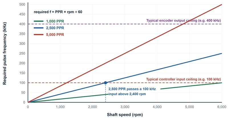

A second, quieter cause of dropped counts at speed is the frequency ceiling (or limit), and it is specified at two different points that are easy to conflate:
  1. The encoder's maximum (ceiling) output frequency, which is the fastest square wave it can generate. This is limited by its internal electronics, often 100-400 kHz for incremental encoders.
  2. The controller's maximum (ceiling) input frequency, which is the fastest edge transition it can detect.
At a given shaft speed, the required frequency is PPR × rpm ÷ 60. A 2500 PPR encoder at 6000 rpm needs 250 kHz. If the controller input caps at 100 kHz, it will silently miss pulses long before the encoder does anything wrong. Quadrature decoding doubles the effective position resolution, but it does not raise either frequency limit; it simply uses both edges of both channels. Always check both numbers against the actual shaft speed, not the catalog maximum.
 Figure 3. Controller and encoder ceiling limits.
Figure 3. Controller and encoder ceiling limits. Image used courtesy of the author
