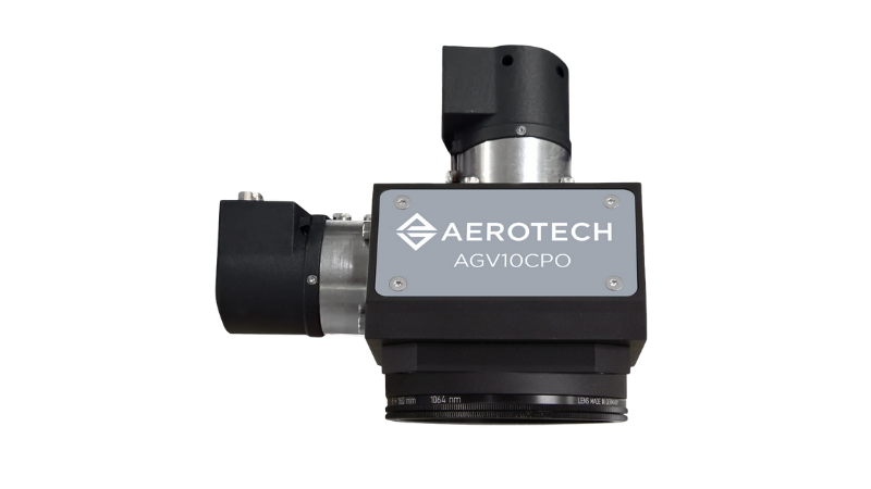

Aerotech has expanded its AGV family of two-axis laser scan heads with the AGV-CPO CORE Performance scanner
Aerotech has expanded its AGV family of two-axis laser scan heads with the AGV-CPO CORE Performance scanner. Image used courtesy of Aerotech

Aerotech has built the AGV-CPO as an entry point solution for laser micromachining applications
Aerotech has built the AGV-CPO as an entry point solution for laser micromachining applications. Image used courtesy of Aerotech

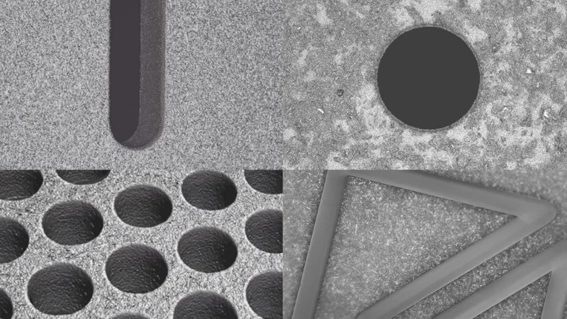

Aerotech’s AGV-CPO is designed for a wide range of machining uses, including research and development, where flexibility and precision are needed for ultrafast laser work. In production, the AGV-CPO works well for medical devices, flat cutting, micromachining, and drilling, as well as for electronics tasks such as display cutting and PCB drilling. It also supports semiconductor processes, such as through-glass via drilling and wafer dicing, and enables additive manufacturing methods, such as two-photon polymerization.
