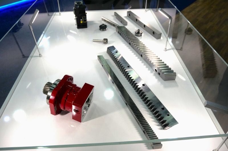

For those unfamiliar with Güdel (as I was before my invitation to the booth), this company manufactures parts that keep the world moving: geared tracks for linear rails, gear drives for motors, bearings, and sliding motion components.
A selection of rack, pinion, and drive gears, as well as sliding motion components from Güdel
A selection of rack, pinion, and drive gears, as well as sliding motion components from Güdel.
