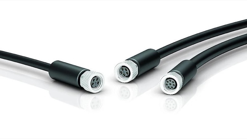

Binder has expanded its M8 connector portfolio with compact, fully shielded cable connectors designed to protect signal integrity in dense and EMI-heavy automation environments. The new 360-degree shielded male and female models bring proven shielding concepts from Binder’s data connectors to the signal level, supporting clean communication for sensors, actuators, and measurement devices. Built to IP67 standards with multiple pin configurations, they offer durability and flexibility for robotics, machine building, and precision equipment.
Binder’s new 360-degree shielded M8 cable connectors.
Binder’s new 360-degree shielded M8 cable connectors. Image used courtesy of Binder
