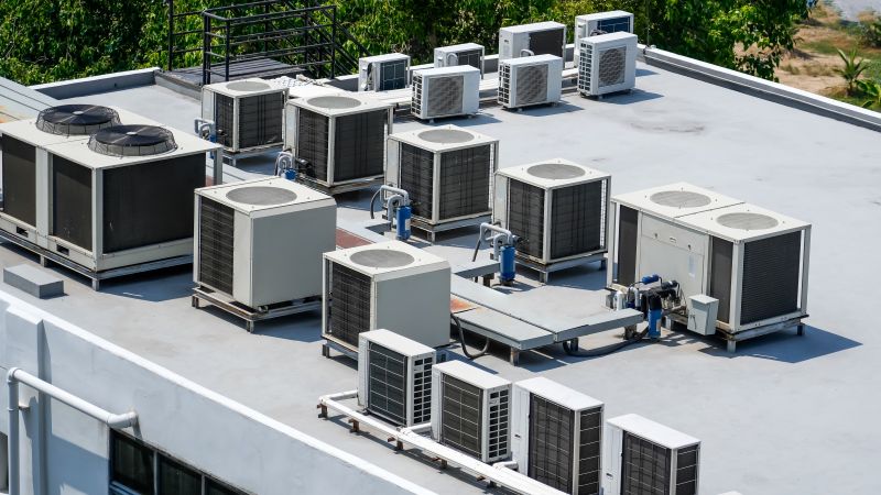

Carlo Gavazzi has built its spark-free relays for HVAC systems using flammable refrigerants
Carlo Gavazzi has built its spark-free relays for HVAC systems using flammable refrigerants. Image used courtesy of Adobe Stock
