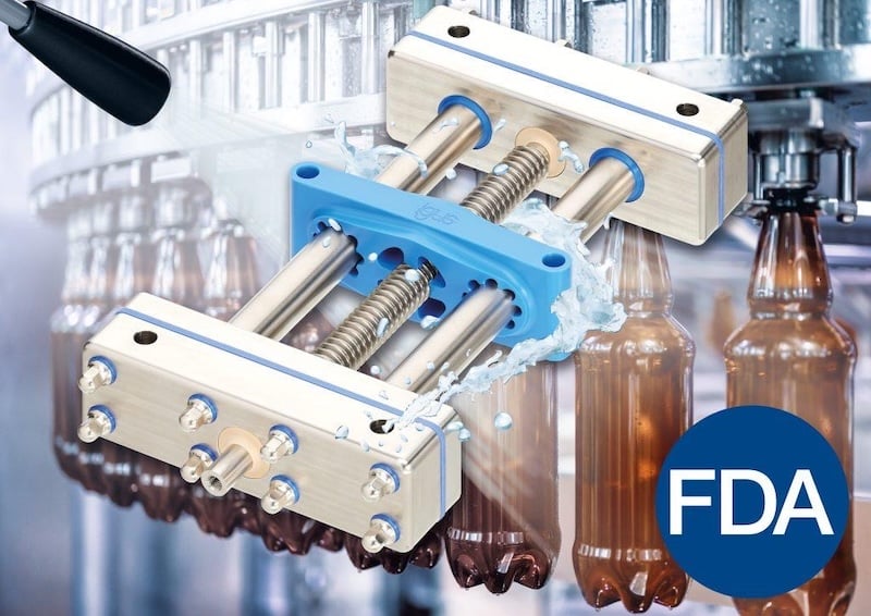

The new hygienic design of the drylin® SHT linear actuator.
The new hygienic design of the drylin® SHT linear actuator. Image used courtesy of Igus

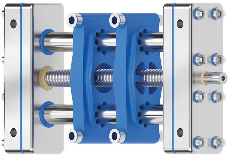

Igus' SHT hygienic linear axis actuator is designed for precise, low-maintenance positioning in beverage production.
Igus' SHT hygienic linear axis actuator is designed for precise, low-maintenance positioning in beverage production. Image used courtesy of Igus
The drylin® linear actuator uses FDA-compliant silicone seals for its truss assembly to prevent ingress of moisture and dirt. Compliant with the EU 10/2011 Regulation and FDA food safety certifications, the polymers used in its design ensure safety and hygienic standards. The new linear actuator technology eliminates the need for external lubricants as it incorporates solid lubricants that improve cleanliness, unlike oil and grease. This lubricant-free technology lowers the frequency of lubrication and cleaning, reducing overall maintenance.
