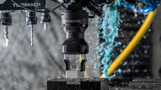

Linear motion cutter
Figure 1. Position sensors are commonly used on linear axes when precise position and speed are required. Image used courtesy of Canva
These linear sensors act not only to measure position alone, but also as velocity sensors in many cases. The linear actuator is sampled at a regular interval. Its velocity is the change in position over the time between most recent samples. This number can be positive or negative, as the linear sensor measures along one dimension. In the same manner, further calculations of acceleration and other properties can be calculated.
