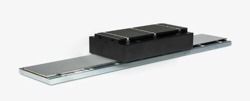

The latest additions to the IC Ironcore DDL motor lineup now support 400/480 VAC-powered environments
The latest additions to the IC Ironcore DDL motor lineup now support 400/480 VAC-powered environments. Image used courtesy of Kollmorgen

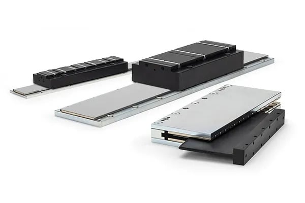

DDL motors have reduced complexity compared to alternatives that require gears, screws, or belts
DDL motors have reduced complexity compared to alternatives that require gears, screws, or belts. Image used courtesy of Kollmorgen

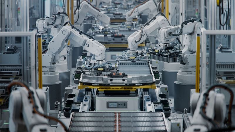

The new high-voltage DDL motors can be used in demanding applications
like semiconductor manufacturing, battery production, and precision machining.
The new high-voltage DDL motors can be used in demanding applications like semiconductor manufacturing, battery production, and precision machining. Image used courtesy of Adobe Stock
