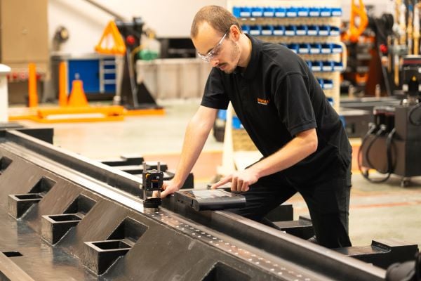

An operator using the XK20 alignment laser system.
An operator using the XK20 alignment laser system. Image used courtesy of Renishaw

At the heart of the system is its ability to measure straightness across unlimited axis lengths. That matters for gantry machines, long-bed mills, and other equipment where older optical tools struggled to hold accuracy over distance. Engineers can now check parallelism and squareness with the same setup, removing the need to switch tools mid-build. The hardware pairs with the CARTO XK20 app, available on Android devices or Renishaw’s own rugged display unit. The app provides a guided workflow with images and animations. That guidance makes it possible for less experienced operators to achieve consistent results while offering the depth of control that experts expect.

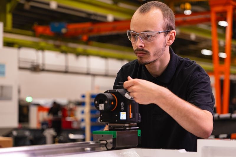

An operator using the advanced long-range measurement mode on the XK20 laser system.
An operator using the advanced long-range measurement mode on the XK20 laser system. Image used courtesy of Renishaw
For production teams, this shift translates into faster throughput and fewer opportunities for mistakes. Compliance data is stored in one place, making it easier to track, review, and present during audits. What once demanded hours can now be wrapped up in one session.
