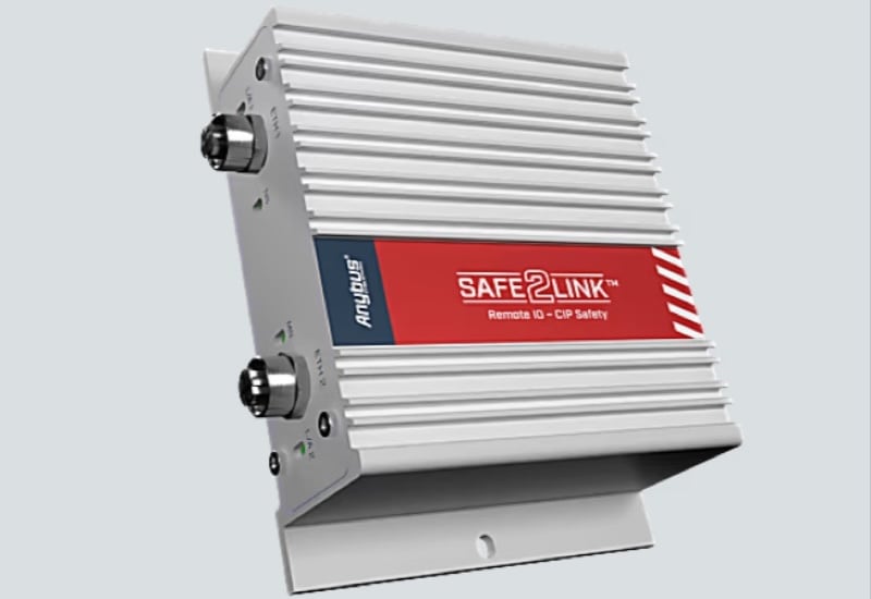

HMS Networks is building out its functional safety portfolio with the release of the TÜV-certified Anybus Safe2Link Remote IO-CS. The system centralizes safety-critical information from sensors and other input devices on automated guided vehicles (AGVs) or autonomous mobile robots (AMRs). It delivers it directly to the control system or PLC to ensure rapid response and avoid safety hazards.
Anybus Safe2Link Remote IO-CS from HMS Networks is a safety-enhancing device for AMRs and AGVs with CIP Safety over EtherNet/IP.
Anybus Safe2Link Remote IO-CS from HMS Networks is a safety-enhancing device for AMRs and AGVs with CIP Safety over EtherNet/IP. Image used courtesy of HMS Networks

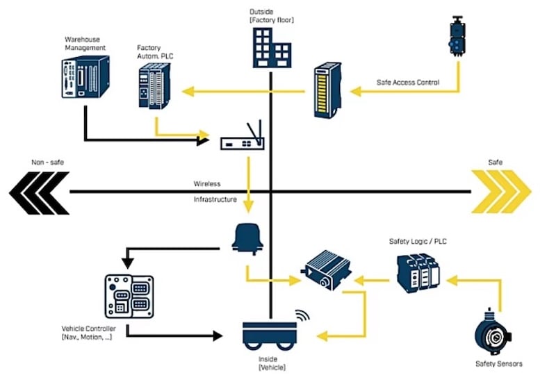

A schematic depicting a use case for the Anybus Safe2Link in an industrial environment.
A schematic depicting a use case for the Anybus Safe2Link in an industrial environment. Image used courtesy of HMS Networks
