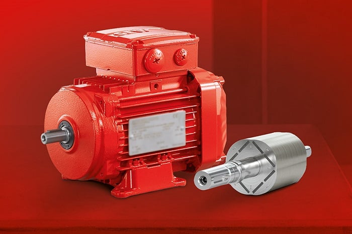

On IPM motors, the Interior Permanent Magnet is embedded in the rotor of the motor.
On IPM motors, the Interior Permanent Magnet is embedded in the rotor of the motor. Image used courtesy of SEW-Eurodrive

In order to achieve such high efficiencies, the motor uses what is called Interior Permanent Magnet (IPM) technology. The technology involves rotor-mounted permanent magnets that are embedded into the rotor itself instead of mounted to the surface of the rotor. This translates to a higher torque density, meaning that the motor can run more efficiently than other motor technologies.
In the case of asynchronous motors in the same power class, the permanent magnet motors achieve a 50% reduction in energy use over standard motors with a rating of IE3.
