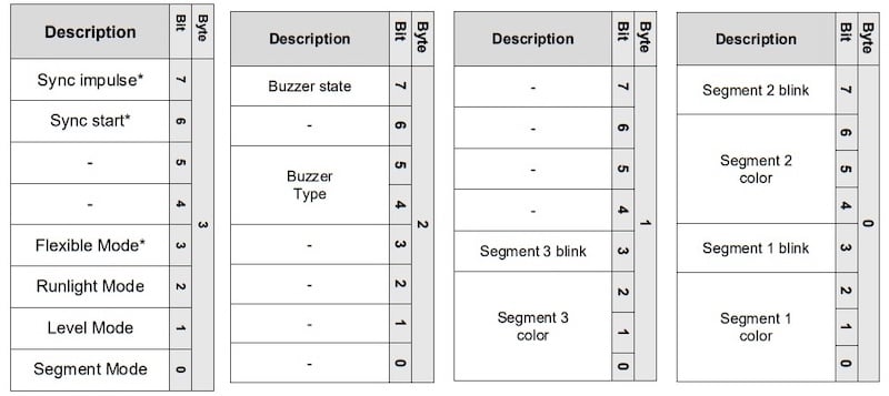

In my project, I have a Balluff stack light that can be programmed in many ways. For simplicity, I’ll run the easiest format where we’ll pick a color for the lower, middle, and top segments, so it will act just like a normal 3-tier stack light. This is called segment mode.
Since the stack light is connected to the second IO-Link port (numbered 1), I know that my output data should be written into IOLink_1:O.Data[38] and beyond. But what should I put in there?
The following datasheet excerpt shows me the contents of the first 4x bytes of data.
 Figure 6. Contents of the first 4x bytes of the stank light output data.
Figure 6. Contents of the first 4x bytes of the stank light output data. Image used courtesy of Balluff
First, the four bytes in question start with byte 38.
Inside IOLink_1:O.Data[38]: 01100101
This will set the Segment 1 color = 101, and the Segment 2 color = 110. These are just presets for orange and turquoise.
Inside IOLink_1:O.Data[39]: 00000100
This will set the Segment 3 color = 100, which is the preset for blue.
Inside IOLink_1:O.Data[40]: 00000000
This byte contains all zeros, as I do not wish to use any buzzer in this project.
Inside IOLink_1:O.Data[41]: 00000001
The single bit commands the light to run in segment mode and immediately, all three segments should illuminate with the selected colors.
Changing any of the colors or modes, if using a valid input range, will immediately appear on the stack light.
