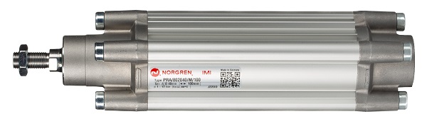

Control.com: Is open-loop end-stop control really damaging for pneumatic cylinders, as some sources state? What protective measures are placed in open-loop cylinders to prevent that damage?
A double-acting pneumatic actuator
IMI: Most pneumatic cylinders are designed to operate with open-loop valves and include built-in cushioning features to prevent damage at the end of the stroke. These typically use hard mechanical cushioning disks or adjustable air cushions to absorb energy as the piston reaches the end cap. Some actuators also include active cushioning control, which automatically adjusts the exhaust flow near the end of travel to minimize impact and wear.
Allowing a cylinder to stop solely against the head or end cap without cushioning can be damaging and may create vibration that can deteriorate both the cylinder and the equipment it’s mounted on. It can also pose a hazard during startup if pressure is applied too suddenly. To manage this, many systems use soft-start valves that partially open to allow downstream pressure to rise gradually before fully opening once a preset pressure level is reached.
While a proportional valve could also be used and programmed to achieve a similar effect, using an actuator with built-in or adjustable cushions is a simpler and more cost-effective solution for most applications.
