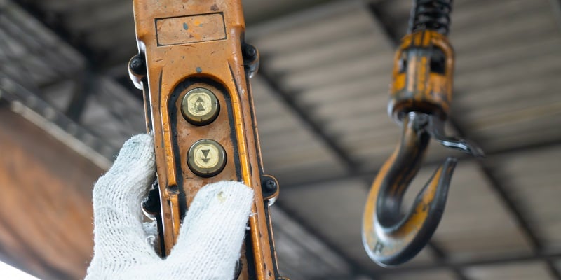

Reversing hoist control
Figure 2. Reversing a crane hoist with a remote control pendant requires either separate motors for up and down, or a reversible configuration. Image used courtesy of Adobe Stock
One benefit of three-phase motors is the ability to reverse rotation direction very simply. The supply wires of any two phases can be reversed manually through a switch, or automatically through a controller of some sort (most often a VFD). One common method of wiring for manual control is to use two contactors in a ‘reversing’ arrangement, where the two controllers are wired using interlocks and reversing bus bars so that one controller handles forward motion and one handles reverse.
