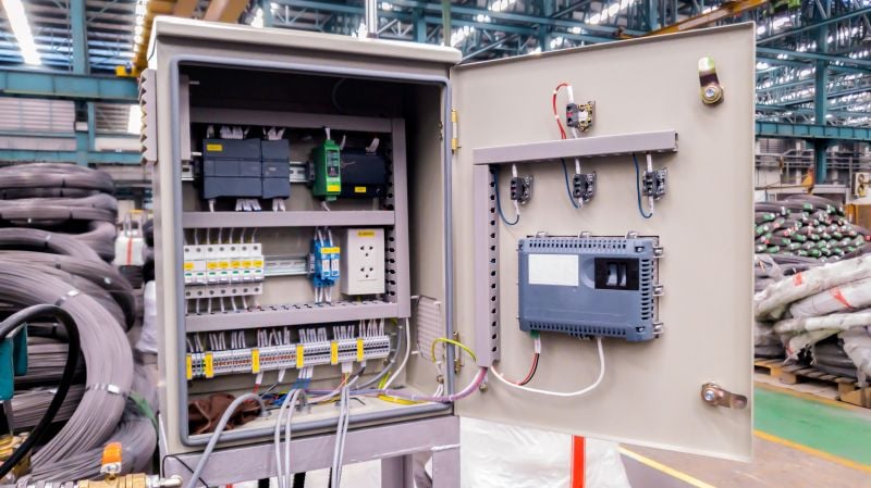

The SPDL series is designed to optimize space and efficiency in industrial applications
The SPDL series is designed to optimize space and efficiency in industrial applications. Image used courtesy of Adobe Stock
All power supplies are rated to IP20, protecting technicians from accidental contact with live components other than the screw terminals. They are designed to be mounted inside a machine or cabinet away from water or dusty environments.
