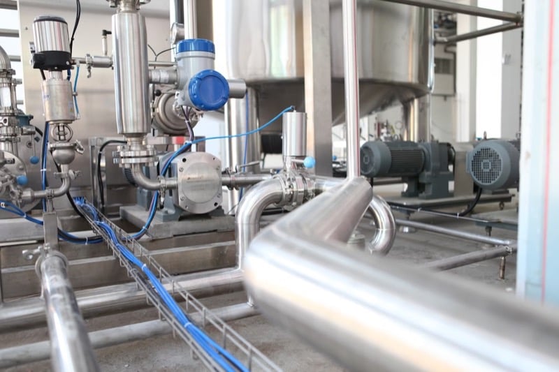

Process automation example with temperature sensors and pumps.
Process automation example with temperature sensors and pumps. Image used courtesy of Unsplash
