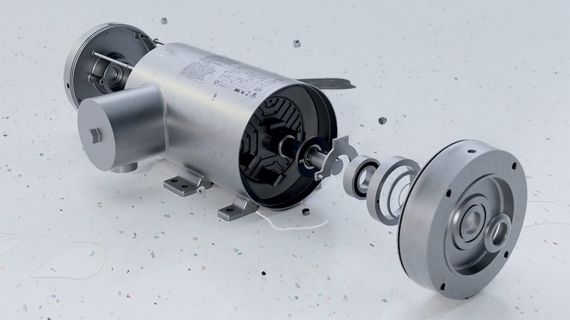

Designed to withstand the rigorous demands of food processing, ABB Food Safe motors provide easy cleaning and maintenance, ensuring long-term reliability. The SP5+ motor achieves IE5 efficiency, offering users energy savings while maintaining high performance in NSF-identified food zones (zone 1). Zone 1 areas are critical since food comes into direct contact with equipment, and the SP5+ is specifically engineered to meet stringent food-grade requirements, making it a good choice for food and beverage manufacturers.
The SP5+ motor can be used in NSF-identified food zones (zone 1).
The SP5+ motor can be used in NSF-identified food zones (zone 1). Image used courtesy of ABB

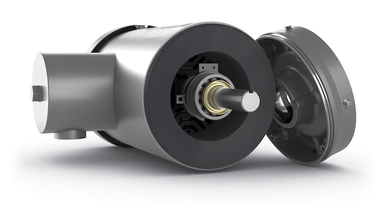

An IP60 rating ensures motor protection against washdown procedures, including direct contact with water jets
An IP60 rating ensures motor protection against washdown procedures, including direct contact with water jets. Image courtesy of ABB
Built for harsh washdown environments, the IP69-rated enclosure gives protection against water jets, steam cleaning, and dust infiltration. This ensures compliance with the strict sanitation protocols required in food and beverage facilities. The SP5+ is designed for long-term reliability and incorporates advanced bearing protection to prevent damage from electrical discharges, a common cause of premature motor failure. By reducing wear and increasing durability, the SP5+ helps manufacturers achieve higher productivity and lower total cost of ownership.
