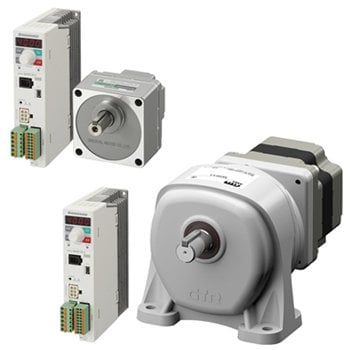

The BLE2 series will now feature 200W (100-120VAC) and a 400 W (200-240 VAC) single-phase brushless motors
The BLE2 series will now feature 200 W (100-120 VAC) and a 400 W (200-240 VAC) single-phase brushless motors. Image used courtesy of Oriental Motor
BLE2 Series BLDC Motors
For applications that need to run on different supply voltages, the BLE2 series BLDC motors now offer new single-phase motor systems: a 200 W option for 100–120 VAC machines and a 400 W option for 200–240 VAC setups. The motors cover the same 80 to 4,000 r/min speed range as the rest of the series and are available with multiple gearing styles, food-grade options, and electromagnetic brakes for lifting or vertical-axis moves.
The BLE2 driver lets the motor’s speed be set digitally, either directly on the unit or by sending an external control signal. Efficiency is improved through a slim stator design that avoids adding unnecessary bulk to the motor. IP65, IP66, and IP67 versions are available, depending on how the motor is configured, while the motor-driver connection is handled by a single cable, and the outlet direction can be oriented as needed to accommodate compact or crowded installations.
