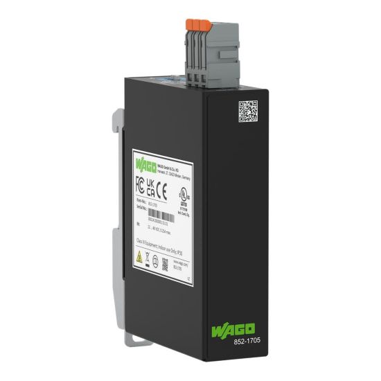

Wago’s SPE media converter serves as a budget-friendly plug-and-play solution for long-range Ethernet connections
Wago’s SPE media converter serves as a budget-friendly “plug-and-play” solution for long-range Ethernet connections. Image used courtesy of Wago
Single Pair Ethernet (SPE) Media Converter
Besides its Ethernet switch, Wago has also released a new industrial media converter. This device acts as an intermediate step between hardware cabling to convert between SPE and 10Base-T Ethernet connections. Data transfer through and along the SPE can be performed at 10 Mbit/s.
Besides data conversion, a pair of these converters can be used to convert data to transmit over SPE, and then convert it back at the end of the line. This is useful for long-distance data transfer, where SPE can support data transmission for up to 1000 m. This is particularly valuable for large facilities, especially those whose electrical noise does not support wireless communication or require the extra security provided by wired connections.
Like Wago’s new unmanaged switch, the new SPE media converter is built to withstand vibrations, mechanical shock, and high heat. The converter is also DIN-rail mountable and provides the same electrical protections.

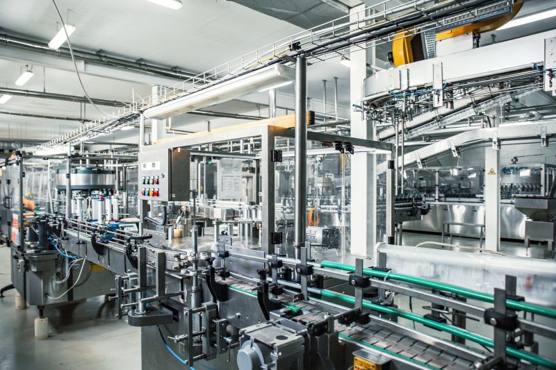

Wago’s newest solutions aim to bring cost-effective connection and communication to automation systems
Wago’s newest solutions aim to bring cost-effective connection and communication to automation systems. Image used courtesy of Adobe Stock
Cost-Effective Connection and Communication
While it might seem like a good idea to replace all hardware in an automation system, it is often cost-prohibitive to do so. Upgrading and expanding production lines often means mixing hardware components and sometimes that includes mixing communications protocols. Wago’s newest automation products, like the industrial media converter, serve as a more cost-effective approach to integrating hardware systems. The new solutions enable users to extend the lifetime and utility of legacy hardware or minimize downtime during system upgrades.
