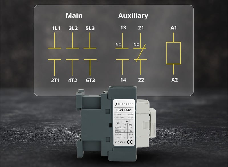

How Does a Reversing Contactor Work?
A standard reversing starter uses 2x three-pole contactors. The forward device connects L1, L2, and L3 straight to the motor in the normal sequence. The reverse device changes the connection of two phases, often L1 and L3, causing the motor to rotate in the opposite direction.
If both contactors close, the crossed wiring can place one phase directly across another. This is not a conventional motor overload. It is a low-impedance phase-to-phase fault.
A mechanical interlock physically prevents one contactor from closing while the other is engaged. It may use a sliding bar, linkage, or integrated mechanism and remains effective regardless of PLC state.
Electrical interlocking provides a second layer. A normally closed auxiliary contact from the forward contactor is wired in series with the reverse coil. A normally closed auxiliary contact from the reverse contactor is wired in series with the forward coil. Energizing either contactor opens the control path to the other.

 Figure 1. Wiring diagram of a three‑pole contactor used as part of a reversing starter, showing the main poles, integrated NO and NC auxiliary contacts, and the A1/A2 coil terminals.
Figure 1. Wiring diagram of a three‑pole contactor used as part of a reversing starter, showing the main poles, integrated NO and NC auxiliary contacts, and the A1/A2 coil terminals. Image used courtesy of Contactor Depot

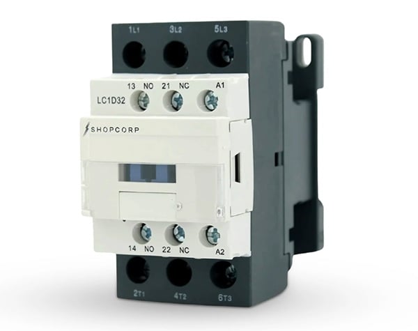

Engineers often source IEC motor and reversing contactors, mechanical interlocks and auxiliary contact blocks, thermal overload relays, and definite-purpose contactors for light commercial or HVAC applications. For reversing service, the paired contactors and interlock accessories must be approved to work together; matching current and coil ratings alone is not enough.
 Figure 2. Example of a three-pole contactor with integrated auxiliary contacts. A complete reversing starter requires two compatible contactors together with mechanical and electrical interlocking.
Figure 2. Example of a three-pole contactor with integrated auxiliary contacts. A complete reversing starter requires two compatible contactors together with mechanical and electrical interlocking. Image used courtesy of Contactor Depot
