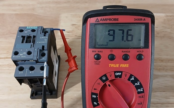

Figure 1. A resistance test of a contactor shows a coil resistance of around 97 Ohms. According to the part datasheet, the value should be 98 Ohms; so this one works well.

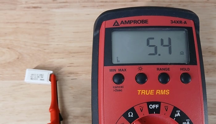

Figure 2. A resistance test for a power resistor. Although difficult to see, the printed value is 4.7Ω. The meter leads are adding about 0.7 extra ohms.

Remember that any extra cable length (even the meter's own leads) will add some slight resistance. A wire may have less than 1Ω of resistance, but that might be significant for some resistors. If the nominal value is in the thousands, a few extra tenths of an ohm wouldn't even be worth mentioning. However, if the resistor is only a few ohms to begin with, like in Figure 2. above, one extra ohm would be a massive change!

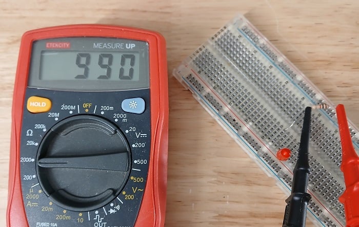

Figure 3. To guarantee proper readings, try to remove at least one connection of the resistor, isolating the component from the rest of the circuit.
