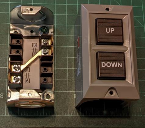

By removing the top and bottom fasteners, the switch box cover is removed. Push the top metal knockout of the box so that three electrical wires may pass through it. Be sure to sand the metal knockout edges to prevent cutting the insulation from the wires.
With the removal of the cover, the terminal block for attaching electrical wires can be achieved. Dupont or 26 AWG solid wire is attached to the three terminal screws. The shorting bar provides a common point for switching either high side voltage or ground. For the Arduino PLC, +5 VDC will be wired to the shorting bar, thus switching high-side control voltage signals to digital pins 2 and 3. Figures 4 and 5 show the cover removed and electrical wires attached to the control station switch box.
switch box cover removed
Figure 4. Switch box cover removed
attachment of electrical wires to the control station switch box
Figure 5. Attachment of electrical wires to the control station switch box
