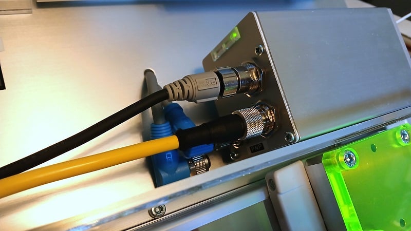

The first consideration for working with the e-Actuator series is the lack of a common ground on the M12 cable that receives the signal inputs. This was also addressed in a previous article, but to solve the problem, we’ll simply need to span a common neutral (- VDC) wire between the e-Actuator system and the PLC system, assuming they are not both powered by a single DC supply.

The e-Actuator uses an 8-pin M12 connector, so be sure to properly interpret both the pin layout for the actuator (Fig. 1, left side) and match it with the proper wire color layout (Fig. 1, right side). There are industry standards, but there are also variations of the standard.

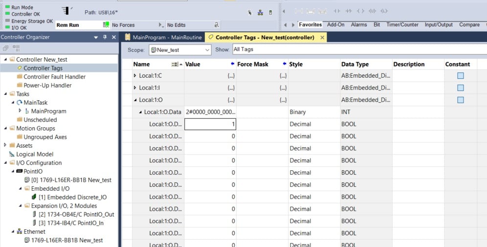

This tutorial can be applied to virtually any PLC with digital discrete outputs, but my scenario uses an Allen-Bradley L16 PLC with embedded digital I and O.
Once the wires were connected and both the PLC system and the actuator system were powered on, it is time to test the function of the system.
Navigate to the global tags and find the output module, which for this embedded system is Local:1:O.Data. Toggling bit 0 will move the actuator to the near end of its stroke. Toggling bit 1 will move the actuator to the far end. Activating both bits should move it to the center of the stroke. This all assumes you have completed my first tutorial for configuring the e-Actuator and placing it into ‘closed center’ operating mode.

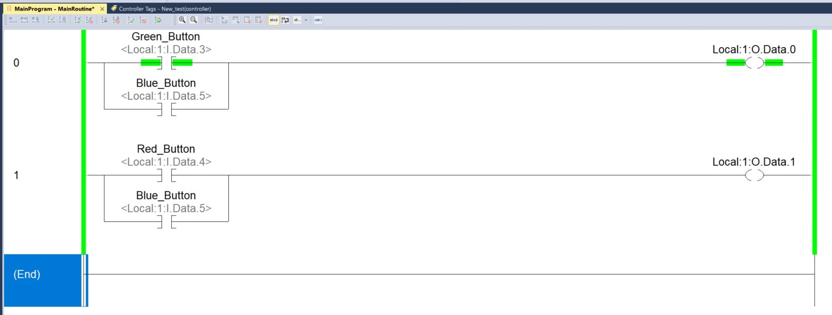

This program will use three momentary pushbuttons, one for each position.
The logic of the program will cause one or both of the outputs to energize when the buttons are pressed. Make sure not to use the same output in two different rungs.
 Figure 4. A 2-rung program to operate one or both digital outputs.
