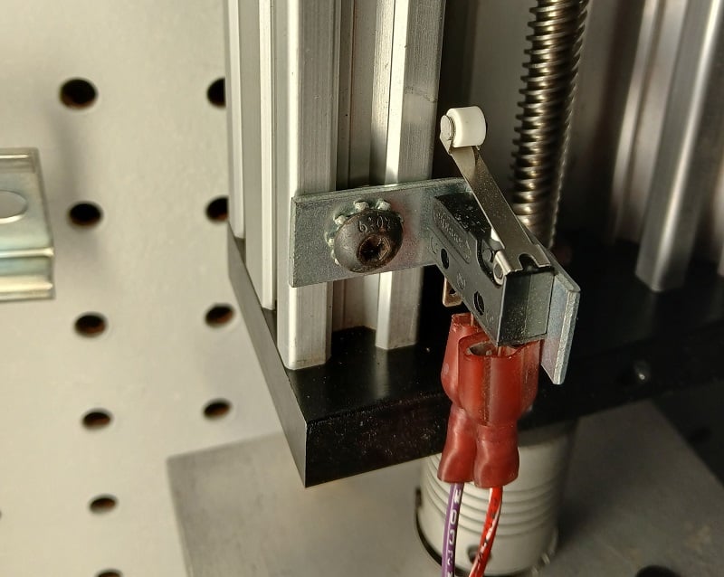

We need to be careful with terminology in this first case. A limit switch is a category of hardware switch that is activated by force on a lever or roller. It can be used in all kinds of object detection scenarios.
However, in motor control, there are many types of switches that detect the presence of a traveling object when it reaches the end of its path. These are also called ‘limit’ switches. For most axes, there would be a limit switch installed at both ends of the travel stroke: a positive limit and a negative limit.
These limit switches for motion axes are not always mechanical. There are many non-contact switches that use optical or magnetic properties to detect travel without encountering any mechanical resistance.

There are many kinds of homing used for motion control. The most common (and easiest to understand) is when the platform moves slowly in one direction until it hits the homing switch, and that immediately becomes the ‘zero’ position. In a slight variation, it may hit the homing switch, then reverse and move very, very slowly back again until the sensor de-energizes. As you can imagine, a tactile limit switch with a lever arm may slowly wear over time, and we'd find that the home position has shifted by mere fractions of a mm. This is why non-contact switches may be more appealing.
 Figure 2. This homing switch is fixed near the motor end of the axis.
