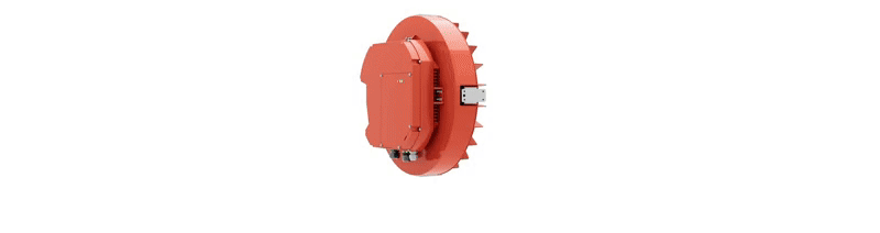

Front and side view of the new motor from Infinitum
The front and back views of the next generation of Aircore EC motors from Infinitum. Image (modified) used courtesy of Infinitum
These air-core motors provide high power and torque density in a flat structure devoid of the copper-clad ferrous cores of traditional motor stator windings. The new motor lineup, with a 20% reduction in weight over the previous EC generation, is designed for use in commercial and industrial HVAC pump and fan applications, material handling, and any other motor application with relatively low power demands.
